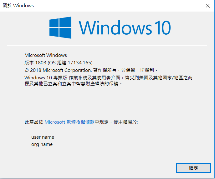

    The most important thing is that I was stuck with the installation step.
    Because the windows version was 1803 (OS build 17134.165)
    I downloaded the last one which is called Media Feature Pack for Windows N (April 2018)
    And then, I double-click the downloaded file "Windows_MediaFeaturePack_x64_1803". But, it showed a message box.
    And told me that "The update was not appropriate for my computer".
    Now, I am not sure....
    1. Whether any installation steps was operated in a wrong way?
    or
    2. Maybe what I can do is to wait for the further updates?
    Any suggestions?
