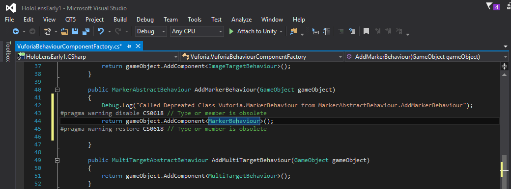

    From the manual "Getting Started Developing Vuforia Apps for HoloLens"
    The Early Access Vuforia SDK for HoloLens will stop working at the end of the calendar year
    The Early Access/Adopter version of Vuforia HoloLens need this patch I have written
    in VuforiaBehaviourComponentFactory.cs to allow VuMark sample to build otherwise the error stops any build
    I have not tested VuMark and samples to work on HoloLens. I am just testing the integration with HoloLens software for successful builds.
