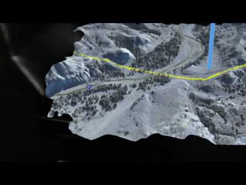

We ordered the Microsoft Hololens with the intention of creating an app that works by streaming our data from the Azure cloud into a 3D holographic environment. We partnered with a local drone survey company to provide high-resolution orthorectified imagery to locations with poor satellite imagery options. One of the other datasets produced by them is a rectified point cloud which we convert to a mesh for use in the Hololens.
The entire process is as follows:
1. A fixed wing survey drone collects images of a project site. These sites can be a small static location or a linear project up to several miles long.
2. The drone mates its flight log with the photographs to create additional metadata that will be used to process the images through photogrammetry software.
3. Photogrammetry software removes the distortion and then uses a process known as bundle adjustment (or triangulation) to increase the accuracy of points in common in an image as well as the images perceived location. Once the process finishes, we further correct the data using survey control points and then re-optimize. The resulting data is the high-resolution image and point cloud (3D model) that are perfectly aligned to the earth surface.
4. We simplify these millions of points into a triangulated mesh that we then load into a unity environment.
5. The Unity3D environment then is also loaded with GIS data (streaming or rasterized) from our Transparent Earth GIS software. The result is what you see in the video. A holographic representation of a section of land with conflated data points.

Any feedback on our shortcomings or improvements would be greatly appreciated. We love to develop for this technology and see the Hololens potential for widespread use. Included below is the video of the ProStar PointMan Holographic app being manipulated in our conference room. We are very excited to be developing this technology and will continue to post updates as we meet our milestones.
