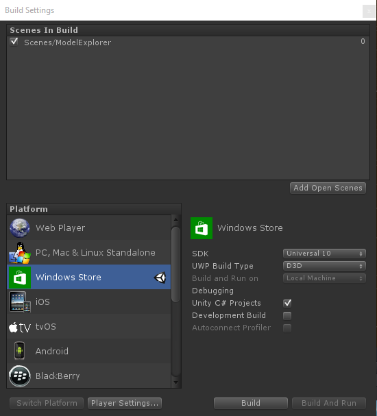

  • @RealityControls,
    When making a 3D holographic experience, use the D3D option. Your Unity build settings should look like this (except for 'Scenes In Build', which should contain 'Origami' instead):

  • @ahillier Yep, that's exactly how mine's setup.
