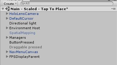

  • Thank you Mark so much for your response. Since then I have drastically reduced my total file size. Yet I am still having a performance issue in 2 of my 3 scenes. I have replaced all large FBX models with simple ones as well as removing a lot of other things and extra scenes. Total file size went from 3.8Gb to 1.7Gb.
    While this did help, I am still getting about 20FPS while looking at a basic FBX that is about 1200Kb total and materials that are just basic colours. Before the performance hit, I had models way larger that were running way better than it is now. This scene is running the worst yet has the least information in it. See the attached image for the small list of things in my scene. The model doesn't update very well when I move around the room. It gets all warped then snaps back into place.
    What are other ways to analyse performance and try to narrow down what is causing the drag?
    I can see that the cpu usage ranges from about 20-30% (when running well) to 30-40% (When dragging) but I can't tell what is being so difficult to process.
