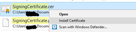

    To rectify this you need to install the PFX which signed the Appx from Windows File Explorer, by right click and select "Install PFX"
    In the Select Local Machine and Select Mark
    In the Windows Certificate Importer, Select Local Machine and check the file path is correct the click Next.
    Select "Mark Key as Exportable". Enter a key or none if you selected none during key generation. Click "Next" through all the next questions and "Import Successful" message should appear
