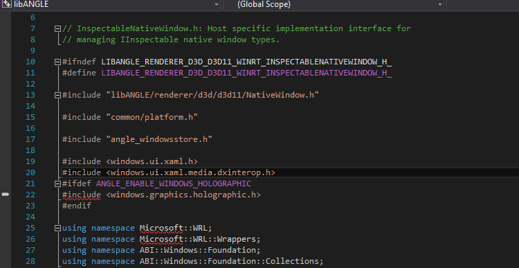

Hi the GitHub distribution is missing some files and declarations which stop the build so general users cannot build this namely "windows.graphics.holographic.h"
when "#ifdef ANGLE_ENABLE_WINDOWS_HOLOGRAPHIC" is enabled.
I also needed to grab some files from GitHub A more universal DirectX SDK can work with multiple versions of Visual Studio, MinGW, etc. to get this far

@Jimbohalo10: Thanks so much for trying this out! To clarify, you do need to use the Windows 10 SDK to build a UWP app in order for VS to find the headers and APIs for Windows Holographic. The Windows 10 app template from the prototype branch is a good starting point for this, and ANGLE_ENABLE_WINDOWS_HOLOGRAPHIC should be defined there in the project properties - if it's not, that's a bug.
The example you found is a good example for rendering to stereo swap chains in a general sense. If you want to see code for rendering holograms, the best place to start is actually the Windows Holographic app template for Visual Studio (instructions here). Stereo render targets are just one aspect of drawing holograms; we also have holographic cameras with hardware-driven view and projection matrices, back buffers and viewports, spatial coordinate systems, and so on. If you want to learn more after reviewing the app template, we also have examples for specific developer tasks over on the Windows Universal samples repo - to find them, visit the Samples folder and look for folder names that start with "Holo". Currently, we have a code sample that shows how to acquire the spatial mapping data, and we have another code sample that uses spatial coordinate systems to locate the user and display a holographic UI message that they can see.
