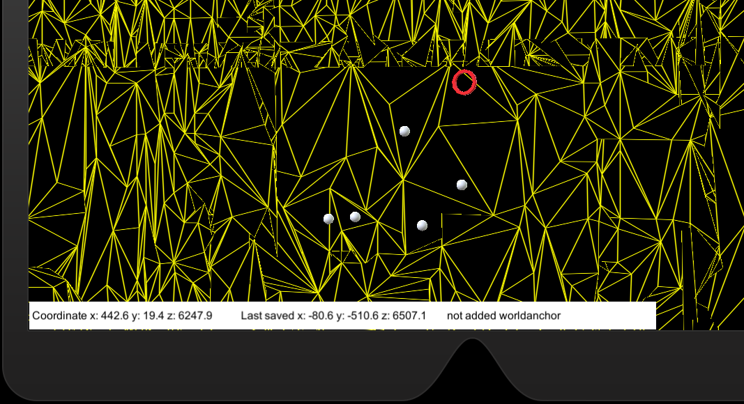

Compiling up the code on VS15 then running it in release mode gave me the top left corner of the scene to look like this
However when I move the cursor around the button gets rotated, scaled and distorted
You can also get this
What I want is to control the upward normal of the UI button as well as the position so that it is always pointing directly toward the observer. Despite using Euler angles or enforcing values as I did for the position it does not seem to improve this situation. Is it obvious what the problem is or am I using the wrong method or am I just a moron?
Sorry I have been a little remiss in not answering neerajwadhwa about using the TagAlong.cs script from the HoloToolKit library. Also I looked at subere23's funky video. I must admit I want to do something completely boring but probably useful for me getting data through in a set area of the screen which tells me something usefl. I must admit I did try the TagAlong.cs script amongst others but in the end got something else working which gave me an instant debug comment on the Hololens Emulator. Not sure yet how it would work on a real HoloLens. Here is a little sample of what it looked like when I tried monitoring the gaze position and where I plonked down my spheres and recorded the position of last one I put down. All units are in millimetres:-
In this example, I have 3 comment messages. All are similar in construction except that the first two comments gets their content from the position of the cursor and the position of the last sphere I plonked down respectively, The last comment is just a note to help me debug my program. The last comment I wrote the following script for:-

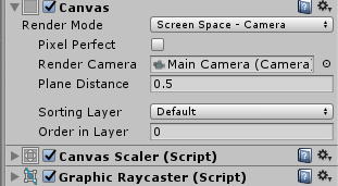

Now I found the heirarchy of FPSDisplay (2) important to have the following items to ensure I got the effect I wanted. Here is the heirarchy I used:-
From my game object FPSDisplay(2), I had to UI Canvas on which to render a white rectangle box on which to write a text script. So a child of FPSDisplay(2) is a UI Canvas.
If you are attempting to do the same pleas ensure that your render mode and render camera are chosen just as I did above.

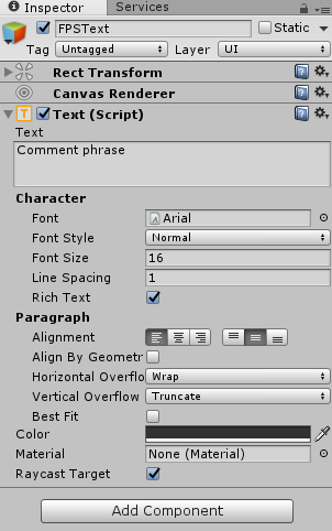

3)The Width and Height I chose to fit the size of font I selected.Finally the child of FPSBackground is a object I defined as FPSText. Please Note: This is a UI Text which I renamed and not a 3D Text.
I chose an Arial font of size 16 to keep in the background box size of 300 x 40 pixels.
Please note I am no expert on this and I got this by just juggling a lot until I found this basic build principle which I found was easy to duplicate and modify for other labels too. I hope you find this of some use. I am sure this is far from perfect and more experienced coders will correct me on several points.
