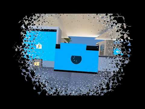

I have used Unity to prototype it. The see-through or pass-through is achieved with a webcam for now. Till the time I am able to afford a ZED mini, I was thinking I could maybe utilize two webcams to achieve stereoscopic.
You can find a demo video here:
https://www.youtube.com/watch?v=5qyiSRHDk3Y
The sample project is here:
https://github.com/syalanurag1991/Microsoft-MixedReality
