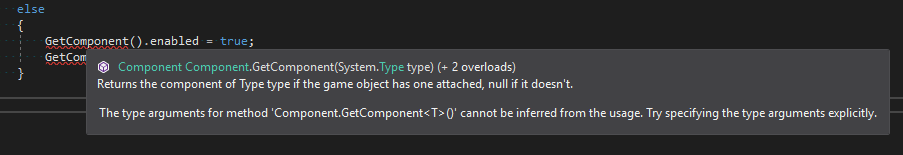

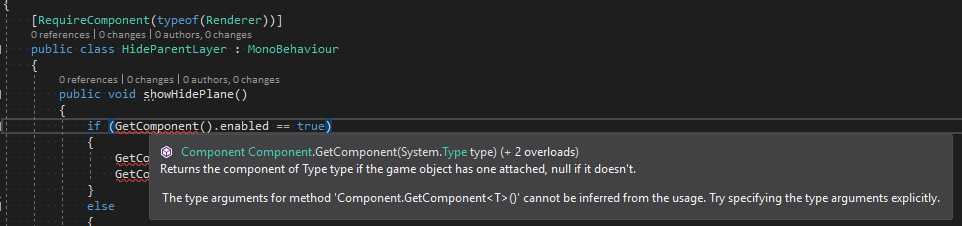

Hmm, when I copy your code into a project to test it, I get some errors around the use of GetComponent:

Hrm, this still errors for me.
Changing it to
will compile for me though. Does that do anything different?

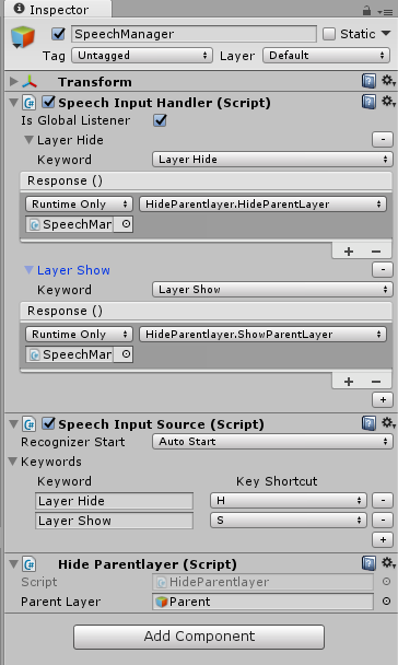

Maybe you can try something like this.
The Script "HideParentLayer.cs" looks like this:
The Inspector with the Parent and all its children. you can add more if you want. And the other GameObjects. All but the Parent and the SpeechManager are straight from the HTK.
The configuration of the SpeechManager.

I am sorry. I was just looking through my threads and I noticed that I did not respond back to you! This definitely did the trick! Thank you for your time!!
