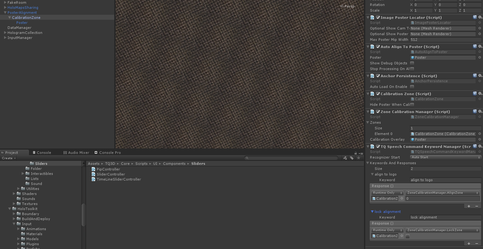

  • Here is our current setup which looks as though we've customized it a bit:
    When we say 'align to logo' (our poster is a logo) we call AlignZone. At that point you should see the alignment graphic appear above the logo or poster. And then within AutoAlignPoster.cs and UpdateLocationFromPoster it will actually line up your object. We customized that code to move our map.
    Taqtile
