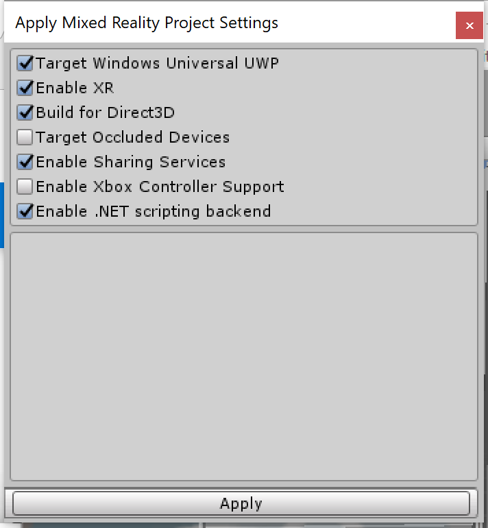

    @dbarrett,
    What David said plus, to make things easier, the 2017.1.2 HTK has this new toolbar configurator in the build and deploy module:
