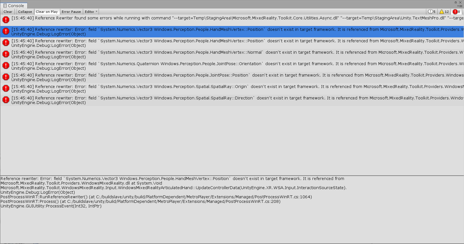

Hi, Indeed,I used the old W10sdk. The update helped me fix those bugs and the project can now build. Thanks. But now there are new errors.
Share me a screen if you want , i can check if i know a way to fix it.
@Kent1LG
Even with all this errors you can build?
I don't remember where but i saw an issue like your's, on the forum,
it seems like this is a know bug, already up to the developpers, just
a little annoying.
I can build a project, because these errors appear immediately after construction, but when you start visual studio project otkazyvaetsya work and there are also errors.
