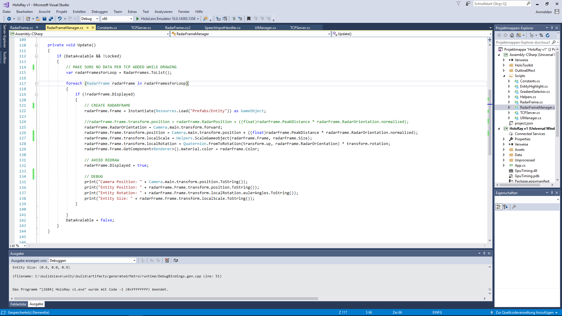

I'm currently working on a project, in which I want to instantiate gameobjects at runtime that should remain at their positions after creation. The instantiating works without problems, but if I deploy the project to the Hololens, the gameobjects keep following me in a certain distance as if there was a billboard script attached. When executed in the Hololens Emulator or with the remote feature of Unity, the gameobjects remain at their position like intended.

The billboard script is only attached to the canvas and the fps display and wasn't modified at all. I've attached the Unity window and the Visual Studio code, where the position is modified.
I will check your guess that the app crashes at some point when running on the device later.
