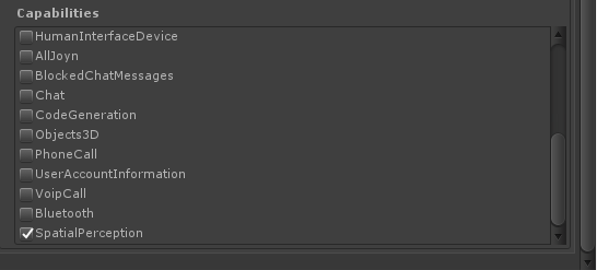

For the mesh not displaying, It's pretty likely that you haven't enabled the spatial perception capability. You can get there in Unity by:
- control+shift+b to bring up build settings
- Click player settings. The inspector (usually on the right) will switch to player settings
- Switch the tab to the windows store tab
- Scroll down to and expand 'publishing settings'
- Spatial perception is all the way at the bottom. You likely will need to move two scroll bars to get to it.

No mesh is displayed when the app launches. I must not have one of the managers configured properly
