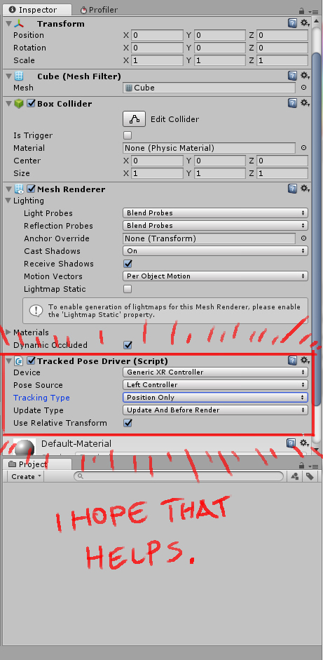

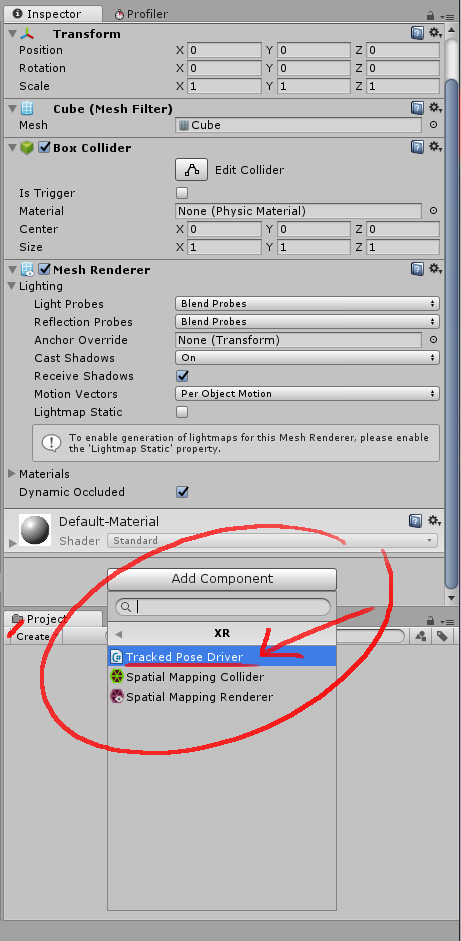

Do you know how to get current effective motion controller transform?
I'm using this for now.
forearch(var sourceState in InteractionManager.GetCurrentReading())
Vector3 controllerpos
sourceState.sourcePose.TryGetPosition(out controllerpos);
I want to get controller's transform, not only position.
  • thank you.
    It works for me!
