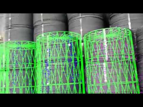

Taken by HoloLens in a steel coil factory.
HoloLens: Steel Coil Measurement
https://www.youtube.com/watch?v=_EMoouFBQjE

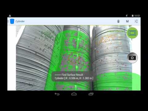

Taken by Google Tango in a steel coil factory.
Google Tango: Steel Coil Measurement
https://youtube.com/watch?v=_QxiurWNVjc

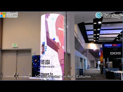

Real-time 3-D Augmented Reality demonstrated at AWE USA 2017, Booth #543 CurvSurf.
https://www.youtube.com/watch?v=_Cao7bVZAMg
This video is taken by Microsoft HoloLens and CurvSurf FindSurface, and edited in 3 cuts:
Cut #1: Finding and measuring sphere, cylinder, and plane in vertex points of spatial mapping with HoloLens.
- HoloLens provides spatial mapping and motion tracking information.
- CurvSurf FindSurface detects, recognizes, and measures the object size, position, and orientation from 3-D point cloud.
https://developers.curvsurf.com/docu.jsp
With the geometric information of real objects, we can make the following simple 3-D AR examples as in Cut #2 & #3.
Cut #2:
- Virtual flying ball around real gym ball with occlusion
- Virtual drawing on real doll house
- Virtual tiling on real floor.
Cut #3: Virtual rotating poster on real column.
We differentiate 3-D AR from current 2-D AR:
- 2-D AR: based on image processing and plane detection
- 3-D AR: based on 3-D object measurement of surface type, size, position, and orientation of real objects.
